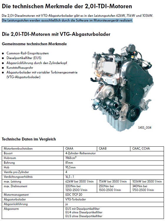

Kada smo vec kod TDI motora i razlika u snazi, evo nasao sam fabricki dokument, doduse motori su za T5, ali jasno pise da je razlika u snazi postignuta iskljucivo podesavanjem ECU. Stepen kompresije kao sto vidite identican.

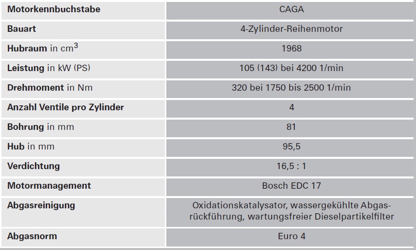

Na Wikipediji sam našao da su različiti, baš piše u zagradi odvojeno za jači i slabiji.
http://en.wikipedia.org/wiki/List_of_Vo ... el_engines
2.0 R4 16v TDI CR 81-132kW
identification
parts code prefix: 03L, ID codes: CAGA, CAGC, CAHA, CBEA, CBAB, CFFB, CBBB, CBDB, CBDC, CEGA, CFCA, CJAA
engine configuration & engine displacement
inline four-cylinder (R4/I4) Turbocharged Direct Injection (TDI) turbodiesel; 1,968 cubic centimetres (120.1 cu in); bore x stroke: 81.0 by 95.5 millimetres (3.19 in × 3.76 in), stroke ratio: 0.85:1 - undersquare/long-stroke, 492.1 cc per cylinder, compression ratio: 18:1 (103 kW), 16.5:1 (125 kW)
Inače po Wikiju, od 110ks jedini TDI motor je sa oznakom CAGA, ovaj što je dragvorl okačio ide u Exeo, Q5, i A4 B8.
Ovi ostali: CAGC, CAHA, CBEA, CBAB, CFFB, CBBB, CBDB, CBDC, CEGA, CFCA, CJAA, u od 120 do 180ks.
